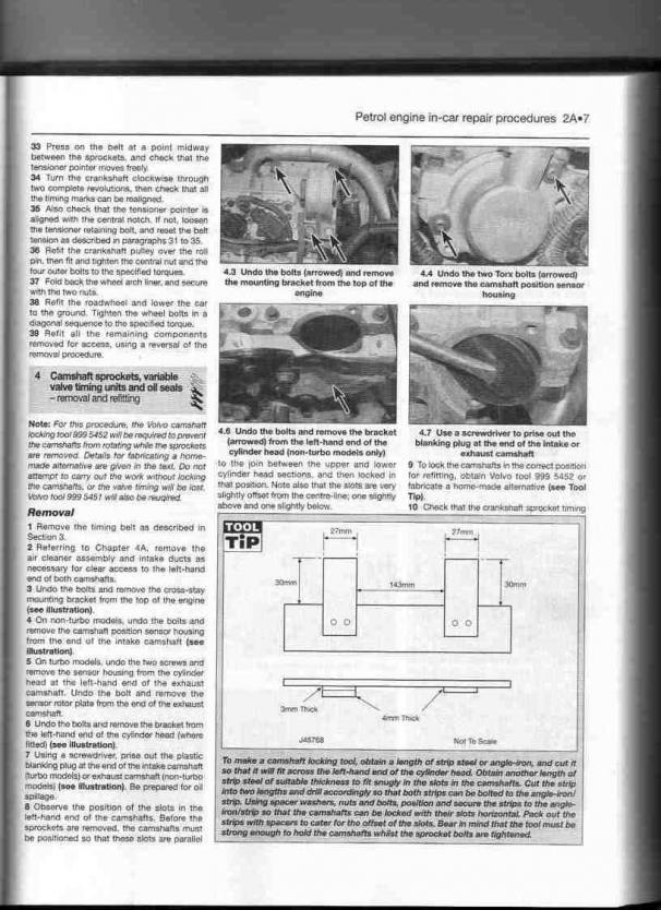

turn until the marks on the wheel and on the plastic cover match, overturn clockwise about 90°, turn back until the marks match again. Then mount the tool to block the camshafts (see attachement; u donīt need to buy the tool in case u donīt have it alrdy)
(I sent u a pm, got some more instructions that I cannot post here due to file size)

Attached Thumbnails Timing belt, vvt, code p1014-vvttimimgprocedure004qz9.jpg
