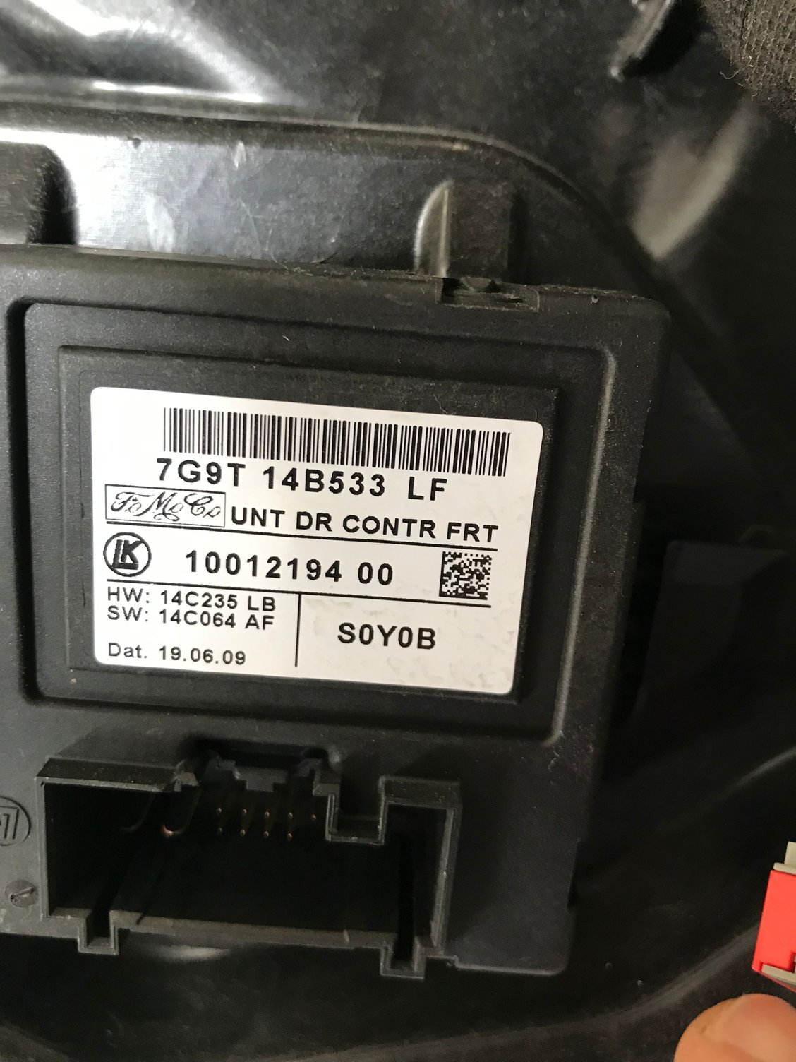

I put a new switch in and the problem persists. I looked for broken wires inside the door and still nothing. I tested and found power on a green/white wire. Got a strong signal on wire going to the unit door control front module but a week signal on the wire going from the module back to the switch connector. Maybe the door module is defective?? Thoughts?
This is the door control module

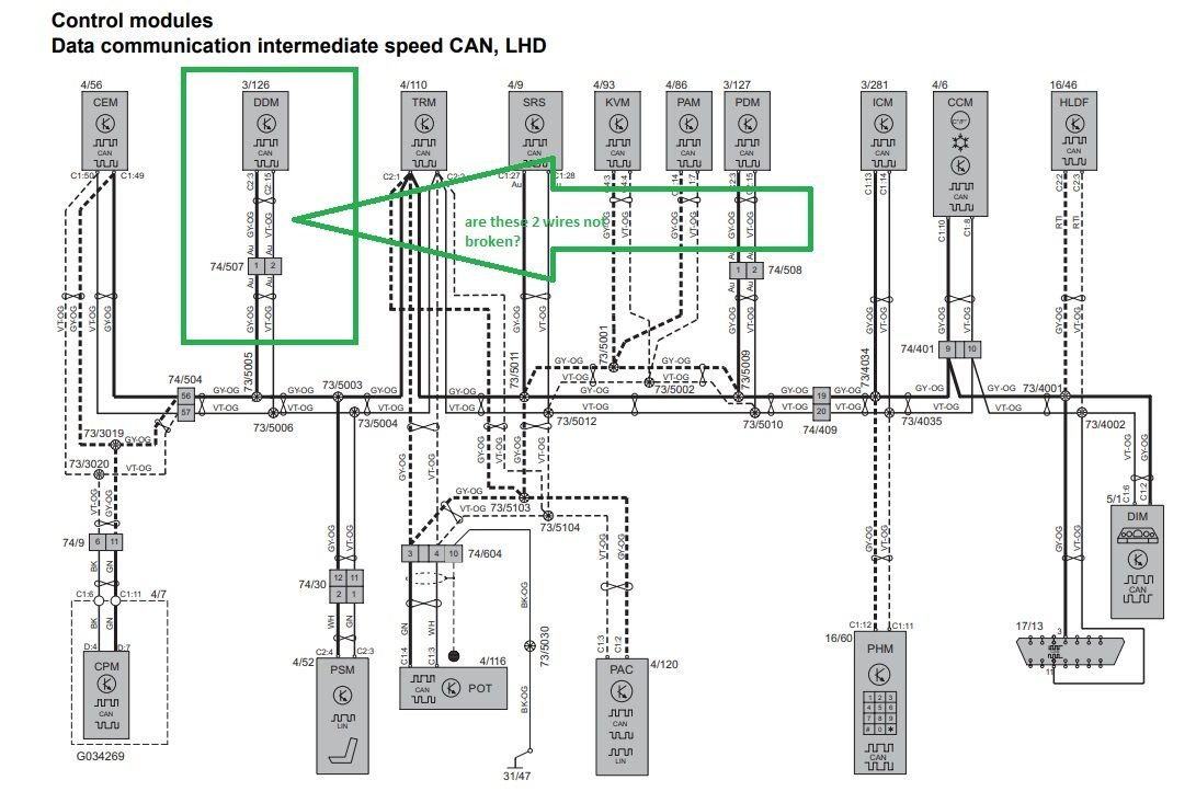

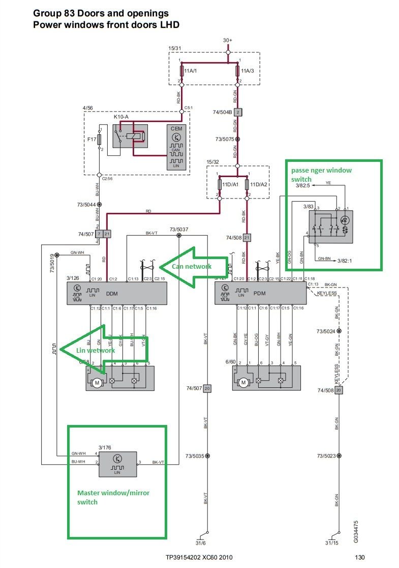

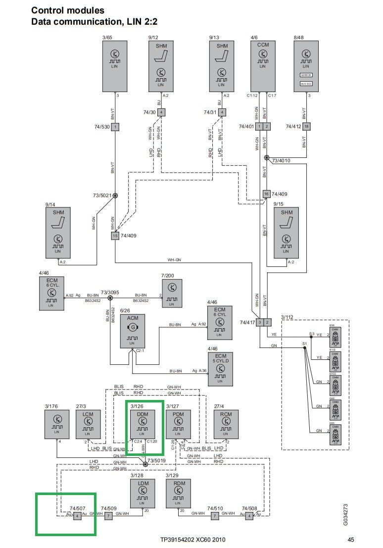

The master window/mirror switch operates using a LIN bus to communicate the switch movements to the DDM. All of that info is communicated back to the CEM using a CAN bus. (with a compatible scan tool, you can move windows by talking to the CEM)
So - if there is a break in a network wire from the DDM - nothing the DDM controls will work. (Is that the case? - no switches work on the master windows/mirror switch?) A common place to have a failure is where the wires bend when the door is opened/closed.
I would check for continuity on the can bus wires from connector 74/507 to the DDM. Specifically is the wire continuous from terminal c2:3 on the DDM to terminal 1 on 74/507 (a grey with OG wire) and from terminal c2:15 on the DDM to terminal 1 on 74/507 (a violet/OG wire)? And if OK I would check the LIN network wire going to 74/507 from the DDM. That would be from terminal 4 on 74/507 to terminal c1:20 on the DDM (a green and white wire) c1 and c2 refer to different plugs on the DDM.

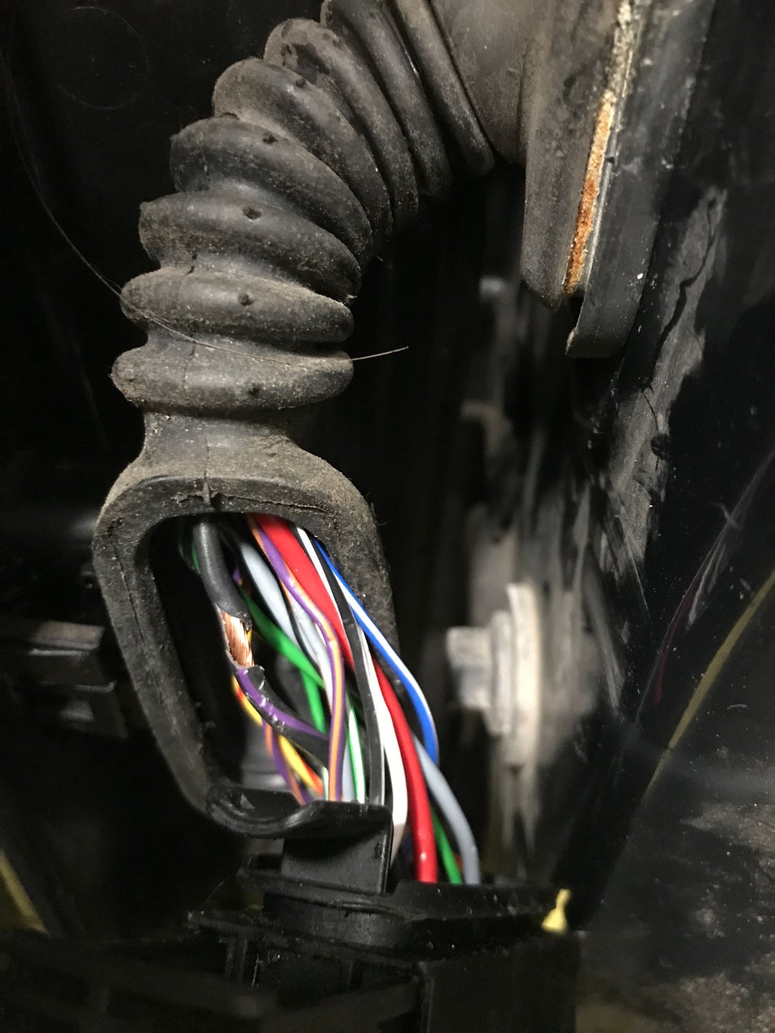

I have inspected the wiring inside the rubber boot but did not find any broken wires. I did find the large black wire with the plastic covering open exposing the wire. Not sure is this could be problematic but I will tape it. I wish I could get pdf copies of the schematics you sent because I can’t enlarge them to read with clarity. I’ve attached a picture of the frayed wire.
