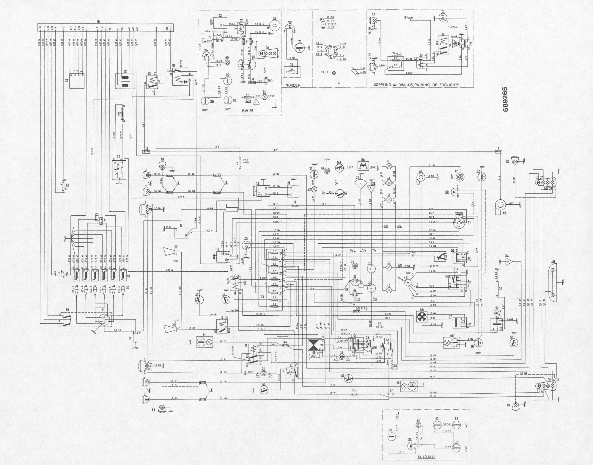

If the wiring is gone though or it doesn't work, the pump is #80 and the fuel pump relay is #79 as it connects to the fuel injection main relay #91 and the big bar fuel injection control unit #76. You can find SXL and GXL 16G wiring for around 10 bucks for 100 feet (usually the minimum order length)
The fuse I think you should tap into if need be is #5, you can find a relay and all the connectors you need on a website like Waytek.
