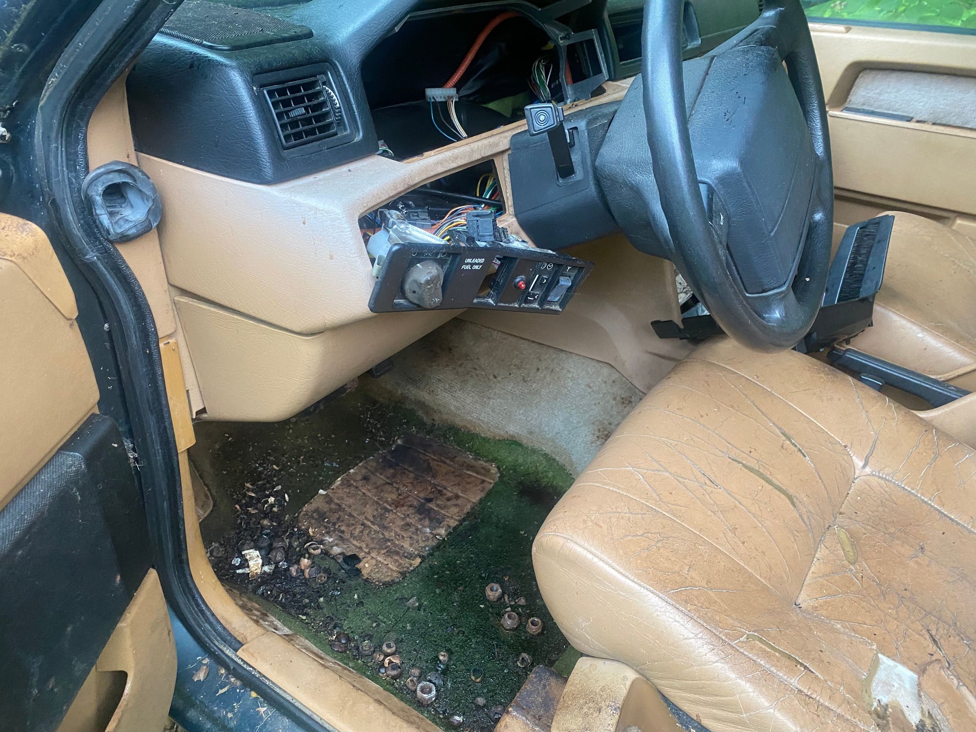

I had a similar problem with mine. New calipers, hoses, and master - still soft pedal. I suspect an issue in the ABS unit, since that's all that's left. Either that or the hoses I got are junk already. I have a customer with the exact same year and model car, only a wagon, and his pedal is right up high. Very little motion gets the brakes working.
I've got a parts car here I can steal the ABS unit out of, but first I'll try braided steel lines on all 4 corners. If that doesn't work, there's nothing left but the ABS unit.

Smithsonite, Thanks! If you are interested in selling the front door panels, please let me know.

I would, but I don't want to get into shipping something that big. If you've got a driver that'll come by I'd be happy to hand them to him. $50 per panel, and they're yours.
