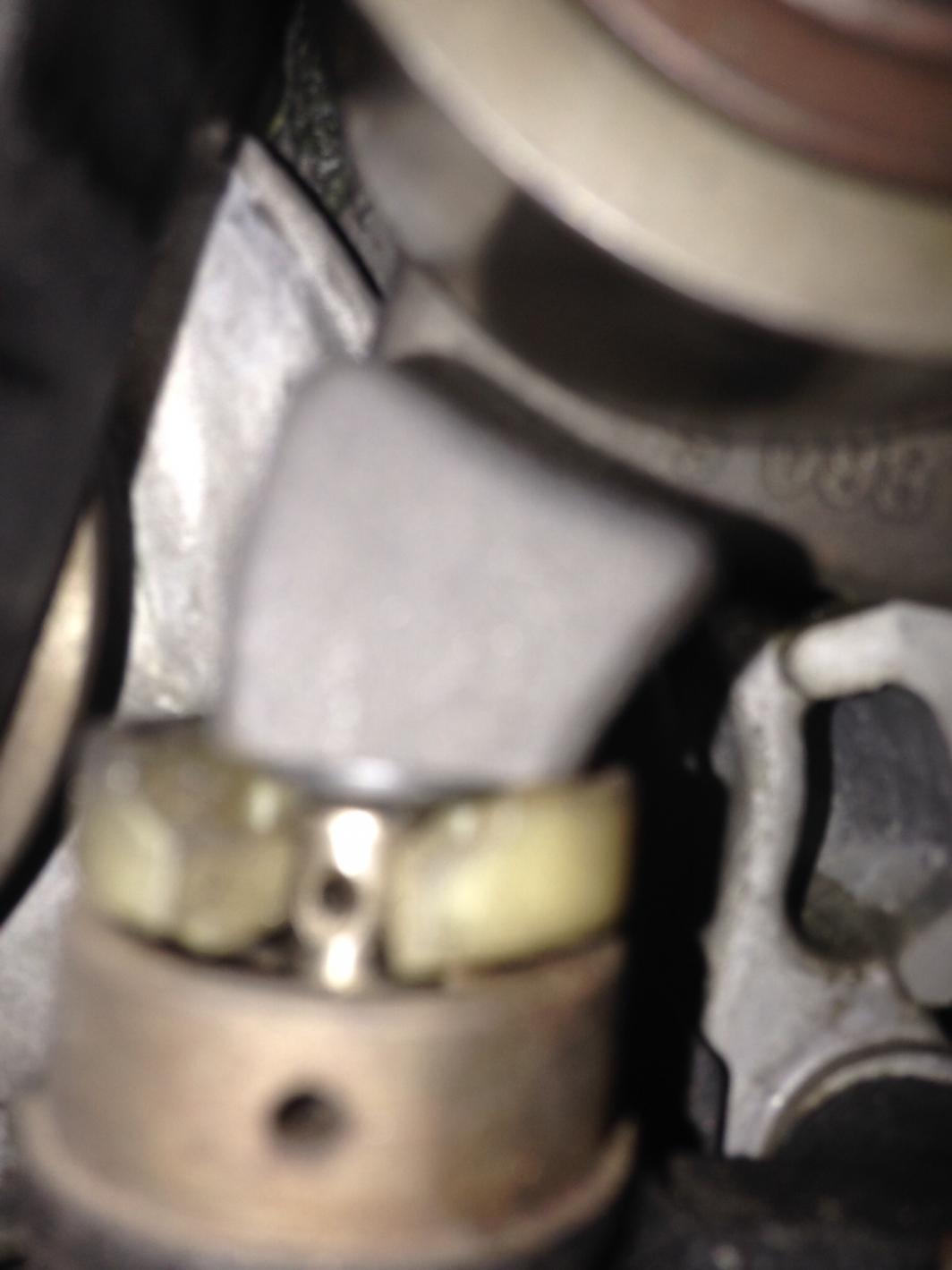

Here is the idler arm and pulley pic, notice how it does not touch is this ok?

That picture is not the idler pulley, its the tensioner and yes, it is supposed to float (not touch) like that. It is keeping the belt tight. The Idler pulley is near the front of the car as the belt goes from the top to the bottom of the engine.

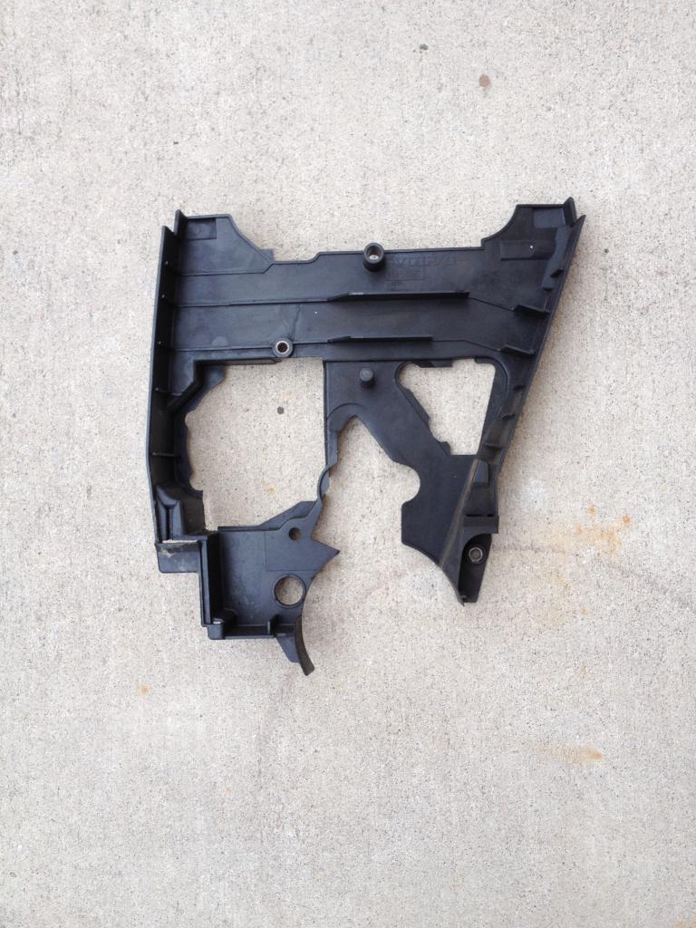

If your just talking about the dust cover that covers the entire assembly, dont panic, you can run the car just fine without it. It, by the way is held on by one bolt in the center and then lifts up to get out. (I think you know this though)
There is a metal cover that goes around the crank that is held in place by two 10mm bolts. These two covers are all that need to be removed to change a timing belt.
If you are talking about the rear plastic trim, meaning the part between the blockand the pulleys, that is held on by two 10mm bolts too. The one you cant see is down by the crank.

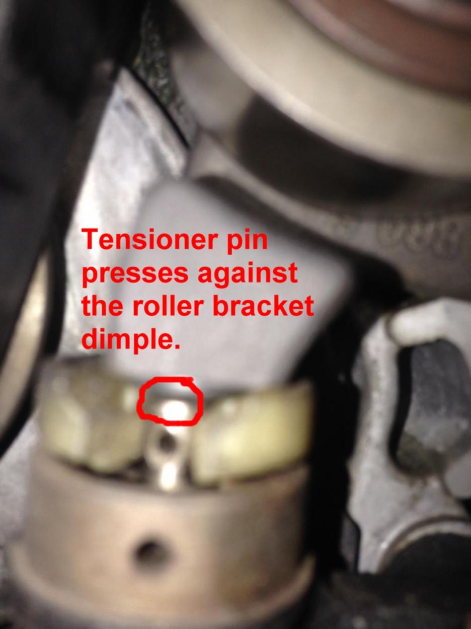

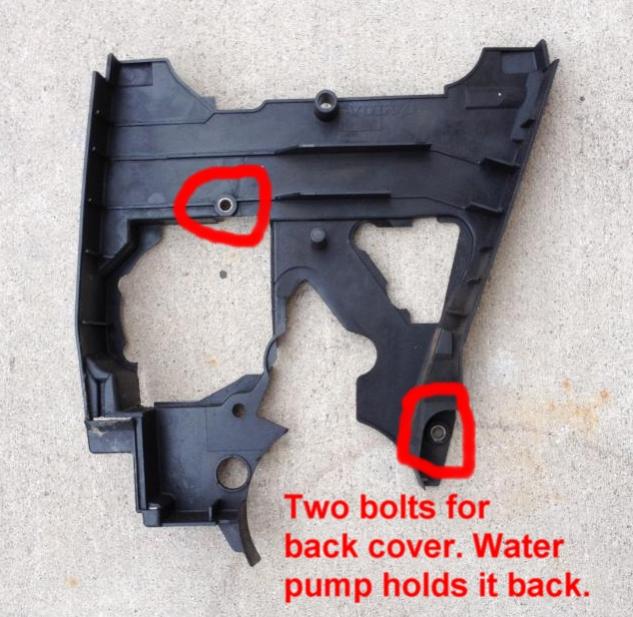

Hey KW, the cover should NOT be rubbing the belt. Make sure the cover is installed properly and it should not touch the belt.
There is no wire in the timing belt.
The tensioner is NOT floating. It has a small round **** on the arm of it and the hydraulic tensioner has a pin that presses against that ****.
The back lower cover is secured by 2 bolts but it is hard to get off with the crank pulley and water pump installed.

I pushed the back cover off of it, seemed like it was not sitting properly, that is when a piece broke off. I could not tell why it was in the position it was. I guessed that maybe it had warped over time . I was going to try to take it off and reseat it, but it looked like you would have to take the balancer off to do it.
