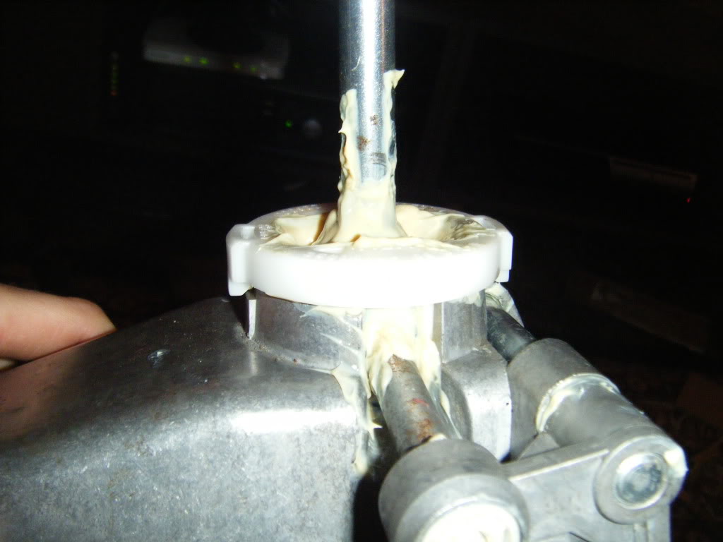

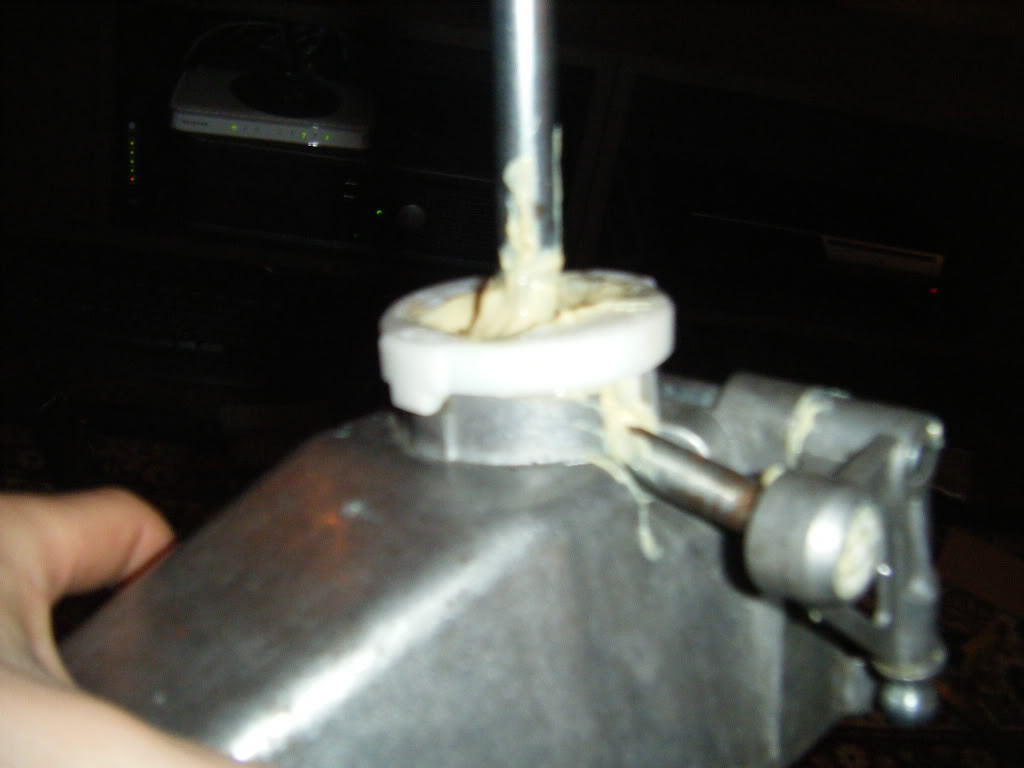

Old ball seat. I think I'm missing a couple tabs. Lol.
And the new one on.

On my way out right now. I just threw on the new boot and **** I bought even though the other ones are fine. They changed them a little bit and the new boot looks 100x better than the old one.
Also got my volt gauge to work and I rerouted the USB cable for my head unit underneath the center console to under the arm rest since my EBC will be going in the 2nd din.
Will post pics tonight.
