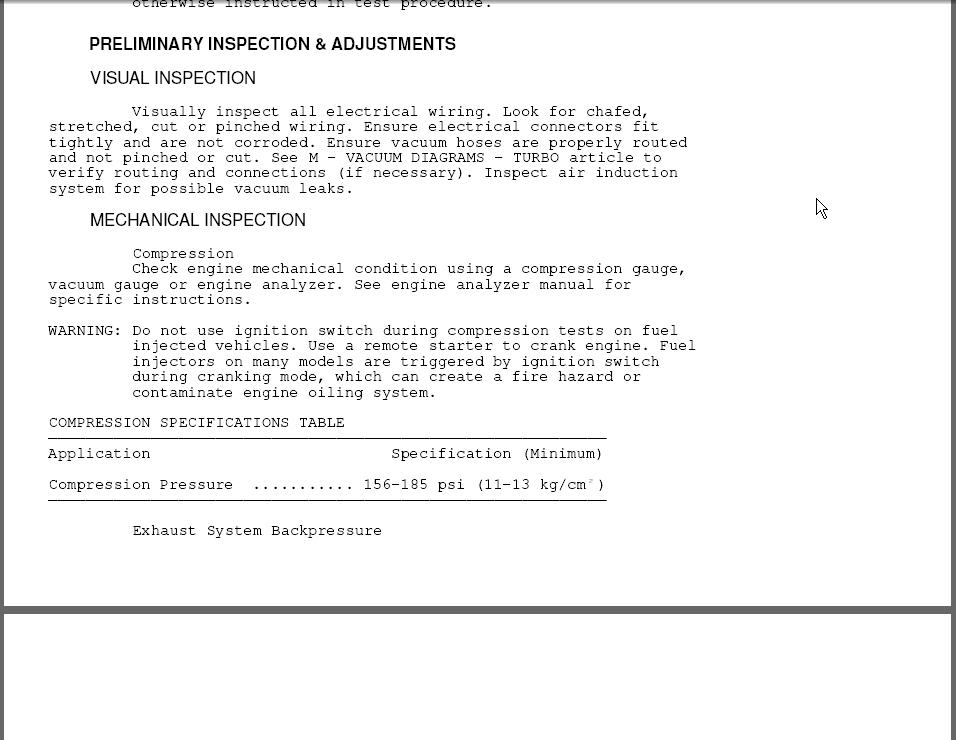

I would think so. Here is a document I found on the compression:

OK. Hopefully I get some good compression then, and once I do that this weekend I will let you know what I come up with.
